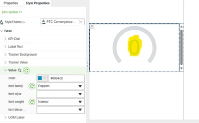

CSS for KPI Dial value
How to change the font size of the value of KPI Dial? Trying to change with some custom CSS (with ptcs style unit) it's not working.
Apr 29, 2025 4:48 AM UTC
The following CSS code is working,
@supports (ptcs-style-unit: "PTCS-KPI-DIAL") {
 [part=value]::part(label) {
 font-size: 16px;
 font-size: 16px;
