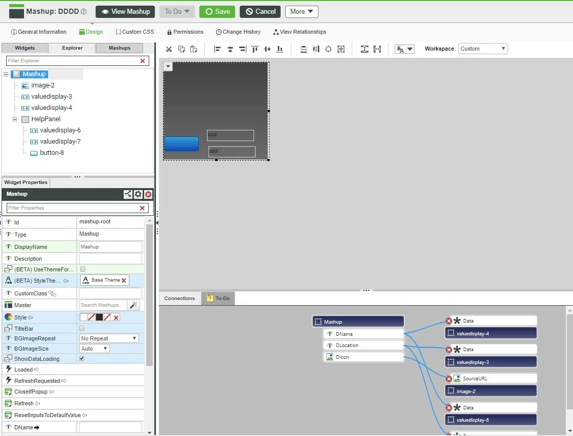

I have created a static mashup and where I have an image and two value display widgets. On that mashup, I have placed a panel widget so my image and value widgets went behind the panel. No on the panel I've placed another two value display widgets. See the attachment for better understanding and all the widgets (one image and four value display widgets) are getting data from an infotable.
Now I want to hide the panel (which means panel and the widgets on the panel) by default and show the widgets behind the panel but when mouser over it, I want to show the panel and its widget.
To do this, need css code. So pls share some codes to complete this.
Hi Rajesh,
Use the below code to achieve it.
.test .widget-panel
opacity: 0;
.test .widget-panel:Hover
opacity: 1;
Don't forget to mention the custom class as "test" into the attribute field of the panel.

Thanks @Sugumar_5656 . The code is working great!
