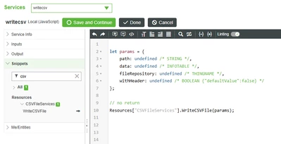

I am using ThingWorx Release 9.3.10,
I  installed the extension but I can able to see only WriteCSV service snippet.
I cannot able to see other snippets like ReadCSV and all.

This extension is creating an entity called ImportHelper. It is specifically designed for Industrial Connectivity.
If you look for a generic CSV Import Tool, use this: https://iqnox.com/thingworx-widget-development/
