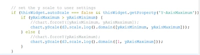

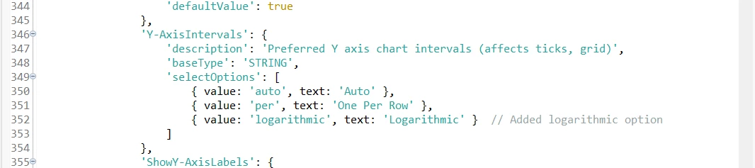

I am trying to Modify the custom chart widget extension for logarithmic scale in Y-Axis in time series chart. After building the code with necessary changes( in ide.js, runtime.js) and importing in Thingworx, I get Logarithmic option in Y-AxisIntervals but chart is not visible in run time.
Getting the following error :
ERROR [widget] "NavigateFramework_CssFiles" widget type is missing required member widgetProperties()
ERROR [widget] An error occurred while calling undefined::widgetProperties(), Id = "undefined", Mashup = "Test234". [{}]
Can anybody help me to fix this and guide me if I am missing anything?
Attached screenshots of the code modified for logarithmic scale.

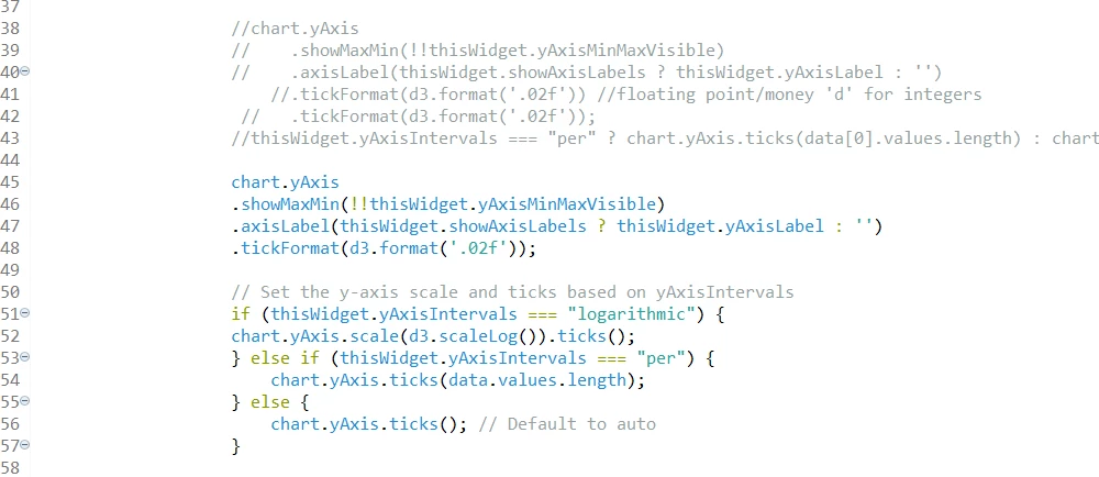

If you try to remove the comment in the IDE.JS, the one you added in the line with logarithmic, does it work?

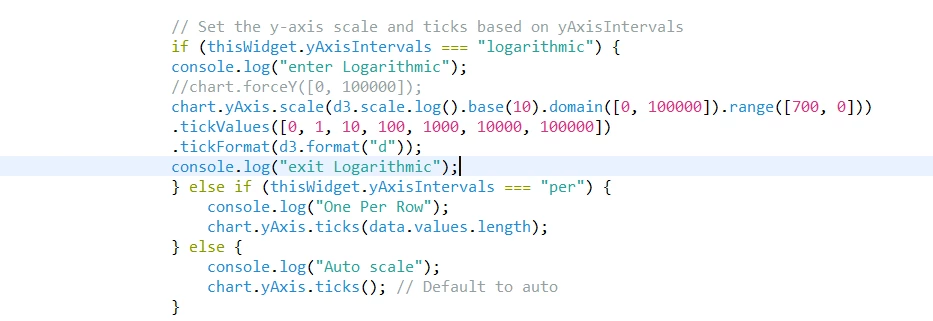

Removing the comment didn't help, Looks like there was an error with d3.scalelog() so the chart was not appearing. After changing it to d3.scale.log() (referring from the library) chart appeared.

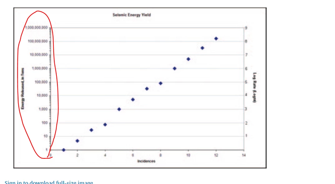

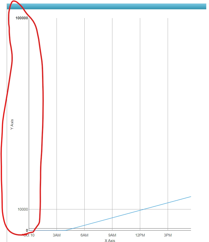

But, still didn't get the logarithmic scale as expected. I am trying to the achieve the scale as shown in the attachment (Expected
.PNG) but the result I get is (Result.PNG). Any help to achieve the expected result?

My 2 cents --
  1. Try to exclude 0 from your domain (log(0) is undefined),
  2. Reverse the range to [0, 700],
  3. I saw some people add .nice() to the scale. I have no idea what it does exactly, but won't hurt to try, i.e. range(...).nice()
