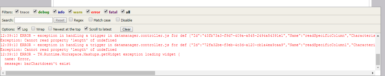

Hi Guys,
I am using TWX version 7.2.1 with Java 8 and tomcat 8.0.  I imported Custom charts widgets version 2.0.4 and tried plotting a bar chart.
I am getting an error as in image attached. I have also imported D3 Tree and D3 network widgets (Version  2.5). Please help me.

20-Turquoise
Aug 17, 2017 2:04 PM UTC
Does the issue persist if you remove the D3 extensions? Does it happen in all browsers?

Hello Kiruthiga!
Does this issue still persist on your system?
If yes, please have a look at the following article:
Article Viewer | PTC
You have mentioned that you have installed the latest version (2.5) for D3 Tree and D3 Network Extensions. Therefore, you should be fine with D3 conflict.
You have mentioned you are using version 2.0.4 of Custom Chart Widgets Extension, and that version uses some special characters that require the JAVA encoding UTF-8 to be enabled for Tomcat (as recommended in our ThingWorx Installation Guide). Could you please confirm if you have UTF-8 encoding? If not, could you please enable it and see if that fixes your issue?
Additionally, as Polina mentioned, if the issue happens on some browsers only, you could also try to clear the local cache of the affected web browser and see if that fixes the issue.

I am facing an issue with Thingworks version 8.2.1.
I am using custom chart widget for time series.
receiving same error like
Error 09:59:04 ERROR - TW.Runtime.Workspace.Mashups.getWidget exception loading widget { name: Error, message: timeSeriesChartV2doesn't exist }
