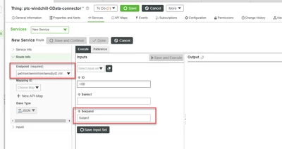

I have created a integration connector with oData connector as base template and able to connect windchill.
Using new composer I am able to map the existing endpoints. For example Workflow/WorkItems. I am able to get few of the APIs available in WRS but not able to see all the exact API Endpoints for example I can see endpoints for GET /WorkItems but I can't see endpoint for GET /WorkItems('{WorkItemId}')/Subject
Also, I didn't find any useful document/code which tells how to invoke GET /WorkItems('{WorkItemId}')/Subject endPoint. Where we can pass WorkItemId as an input parameter and get the details. In case of Legacy Rest I was using below code to get the data. Not sure how to achieve the same using OData.
var jsonResult = me.processJSONRequest(params);
Any idea, how to achieve above requirement using OData REST API.

Issue discussed through case :
In ODATA connector, create a Service and enter information below :
  • Endpoint (required) : getWorkItemInWorkItemsByID (/Workflow/Workitems({'ID'}) GET)
  • $expand : Subject
Solution reported in article : https://support.ptc.com/appserver/cs/view/solution.jsp?n=CS338990

I verified the API that I am looking for is available in Windchill, I have ran it in Windchill and it returns the data well. I have attached all the required screenshots. I hope the screen shots help. I would like to know how can I get data for /WorkItems/('{workflowid}')/subject REST call from my Thingworx service. All I could see are few out of the box services available for /WorkflowItems in Odata Connector and not all as is seen in Windchill. It will be really great if you can let me know how I can include and call these services from Thingworx.
