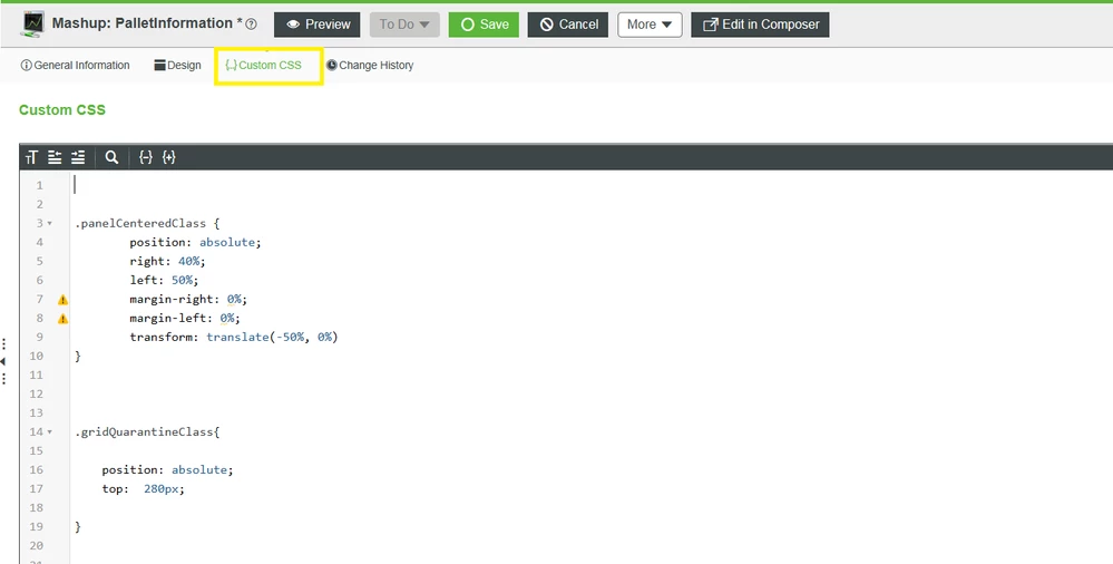

May 3, 2018 2:02 PM UTC
Hello mtahir1,
Adding custom CSS to mashups was introduced in ThingWorx 8.2. You will find the Custom CSS tab when you open the mashup in the New Composer.
