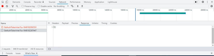

Hi @KN_9954684.
Have you tried using your browser Dev tools (F12) for troubleshooting?
Regards.
--Sharon
March 25, 2022
Java service when executed from Thingworx gives empty result but expected is to generate token key
