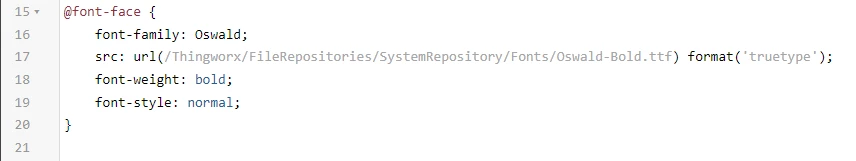

I uploaded a font-family into System Repository and use that in CSS to change the font-style of my labels. But this only works for users with administrator rights/permissions. What must be done to apply the css (which refers to the SystemRepository/fonts) for non-admin users?
Please refer to the attached CSS image.

Don't look under the Repositories. SystemRepository is a Thing, so go to Things and in the filter set the checkbox for System Objects. You should see it then. Then its business as usual under the thing's permission tab.

You need visibility on the SystemRepository and Service Execute privilege on GetFileListing.
