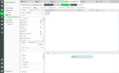

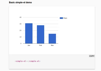

Built an Custom widget, based on the Polymer JavaScript  , when Extension ran through the Web Application, the chart looks like below Image:
After importing the Custom-widget.zip file in to the Thingworx and when tried to show it on a Mashup, no chart appears
And when viewed, following error is seen in the web console:

Bar chart image was developed in web application, by using polymer and google web components charts. Bar chart image is output from the browser.

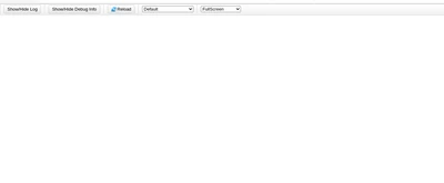

Issue:
After built, Mashup widget I.e (extension.zip) file. After importing file into mashup. It the showing none
After saving the mashup and when we click on view mashup.
Where we are seeing the mashup output in browser. It is showing blank.
But in the console, we are getting as below the image displaying.
And Error Content:
Failed to load resource: the server responded with a status of 404()  /Thingworx/extensions/base.js:1
Failed to load resource: the server responded with a status of 404()  /Thingworx/extensions/lit:1
