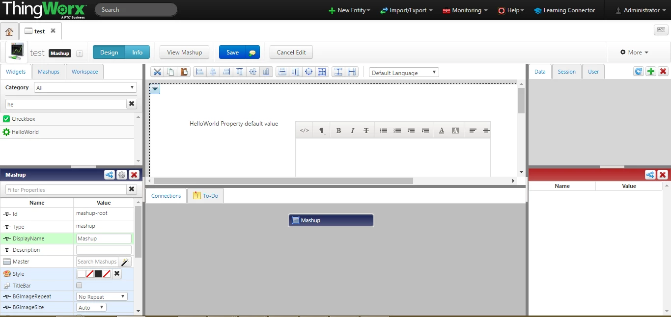

I am new in creating custom widget, following are the steps are did,
- Used Eclipse thingworx plugin.
- Added default HelloWorld widget and build it using gravel.
- Imported the extension project into platform.
I was able view it in IDE (check ide.png). But not able to view same widget in runtime(check runtime.png), not sure what I missed.
Would like to what I have missed as soon as possible

Penchalaiah, it now works fine on a new Mashup? If you come across this issue again, try clearing your browser cache (or view the Mashup in an incognito/ private browser window) and retry.
August 9, 2016
Are you sure the check box under properties for "IsVisible" is checked?
pyekula1-VisitorAuthor
August 9, 2016
Yep. Not sure what happened, suddenly the custom widget start to appear after trying it new mashup
Aanjan5-Regular MemberAnswer
August 9, 2016
