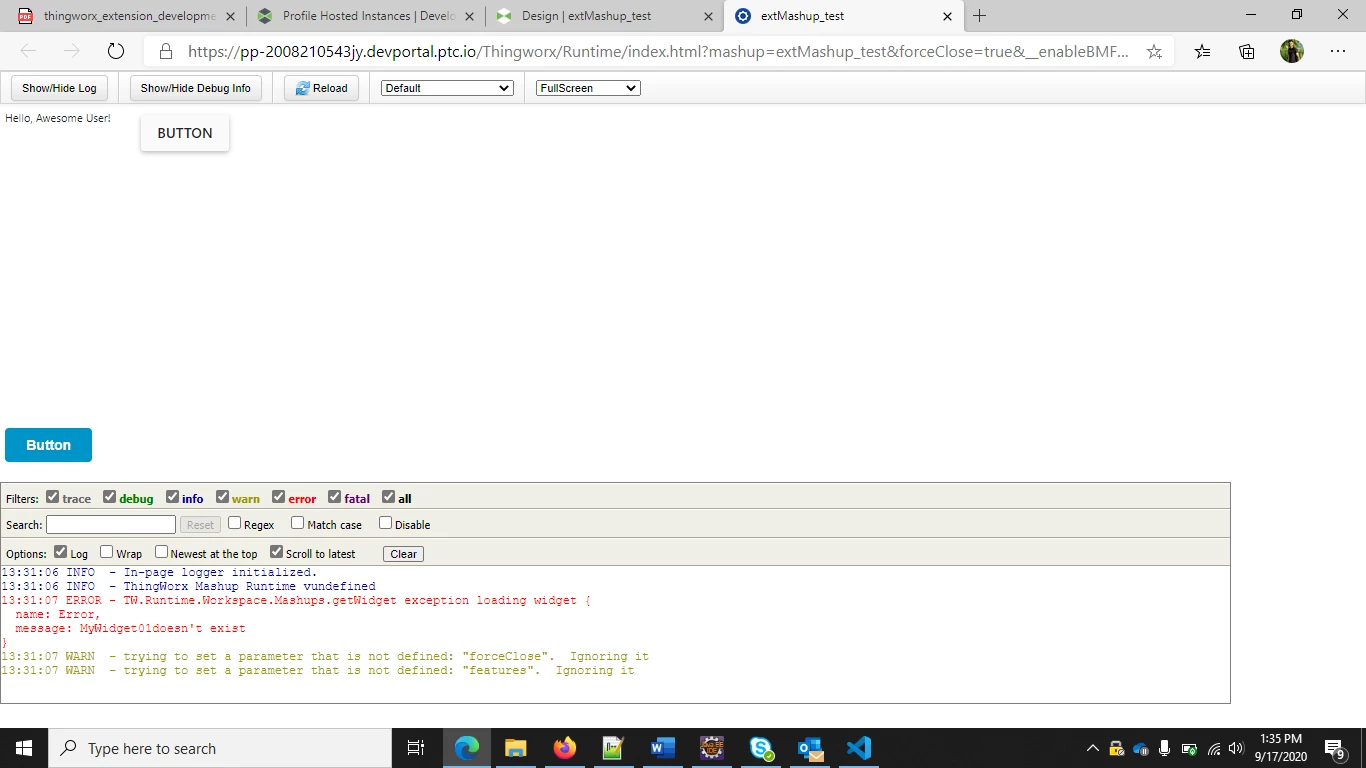

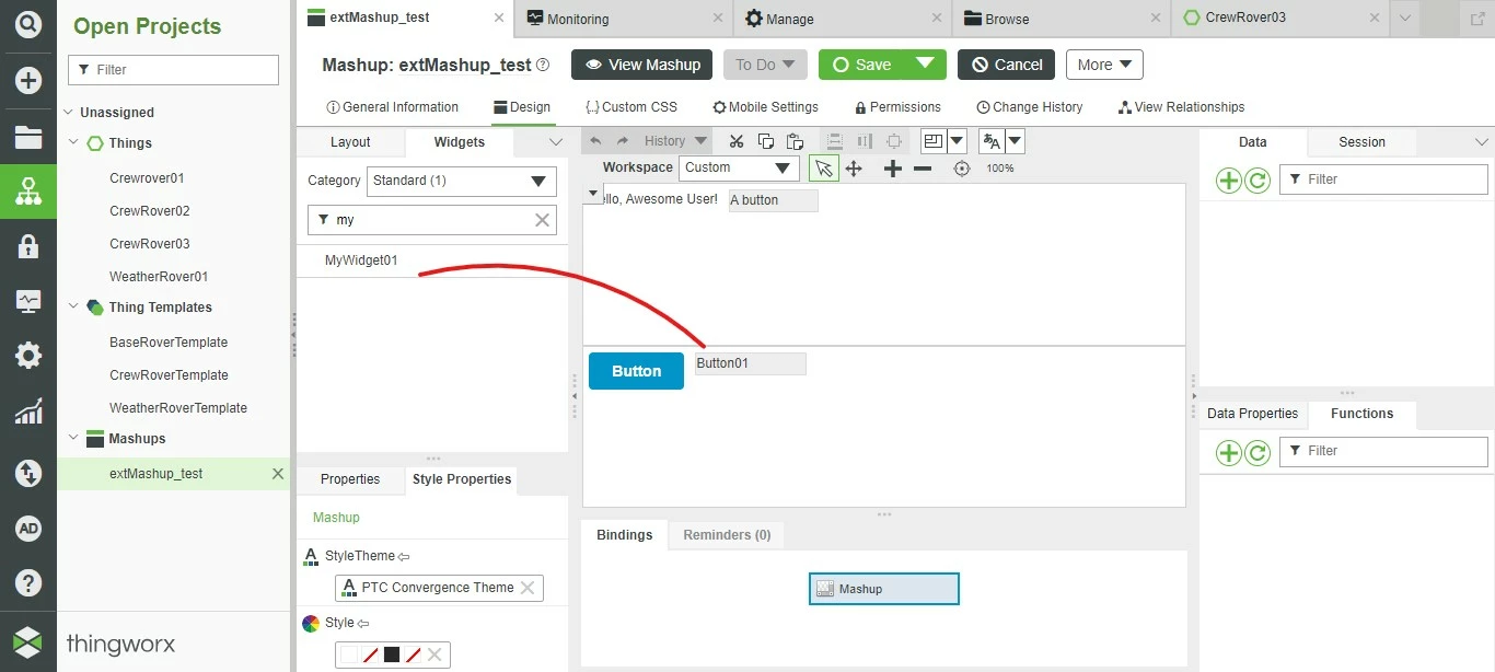

I have created a custom widget, I can add it to my mashup. But when I view mashup that widget disappears and error shows <widgetName> doesn't exist.
I am attaching screenshots and extension zip file for reference.

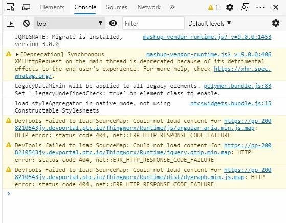

What does your browser console show?  Any errors there?
 No errors there, few warnings though.
consoleconsole
