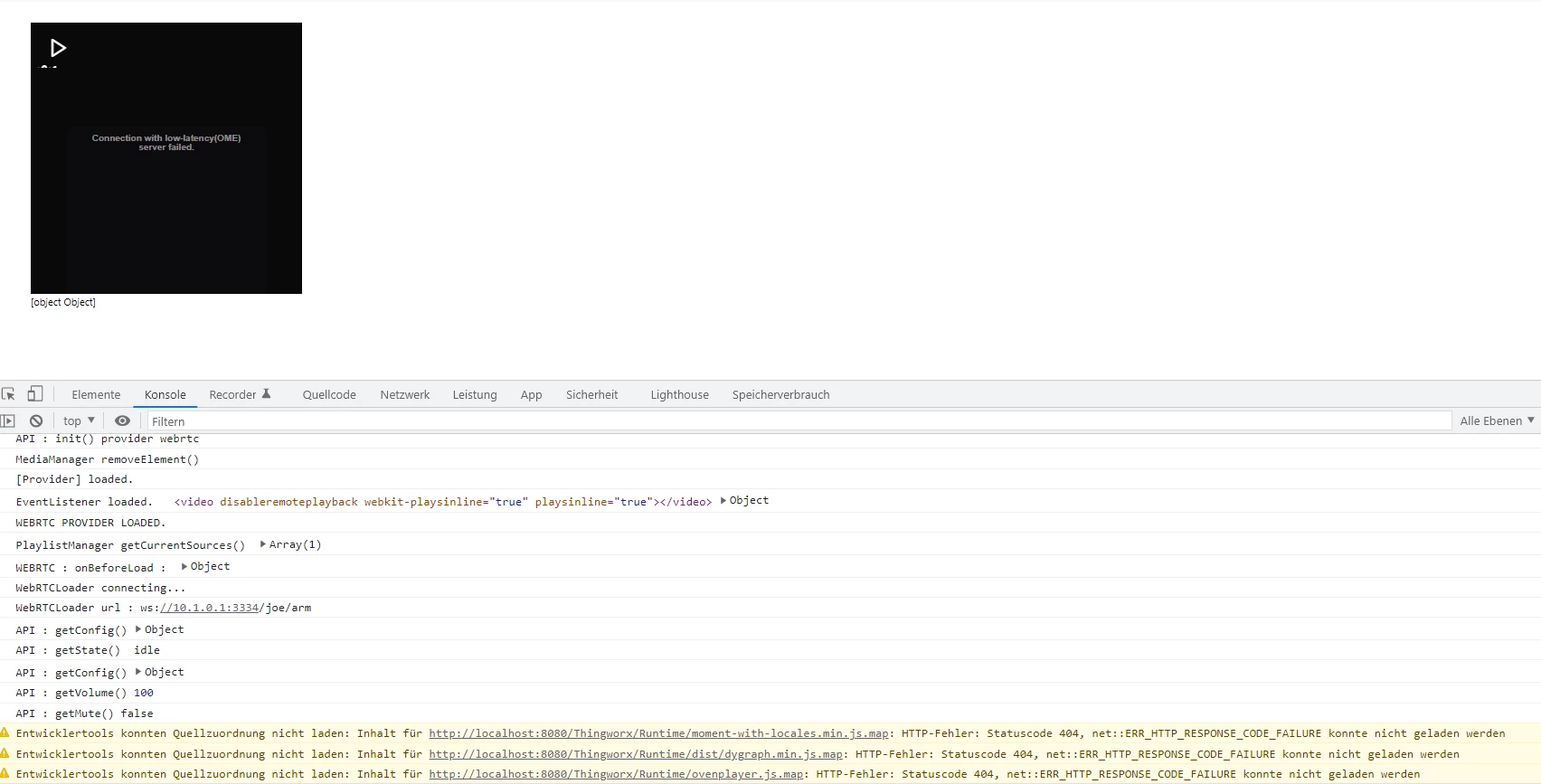

I created a custom widget in order to integrate the OvenMedia WebRTC player (https://airensoft.gitbook.io/ovenplayer/). I included the Third part javascript and the player is starting on my local computer but not in the production environment. What could be the problem & how can I analyze this?

It was not the case but I imported the missing extensions on dev and it is still the case. It seems that the Third part js is not loaded at all on prod.

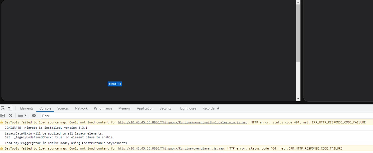

we can see on the screenshot attached at the top that overplayer.js seems not to be loaded. I tried several path without success but I'm wondering that this is working well on my computer.
There is a 404 error on both systems, prod and dev, but this is related to the file ovenplayer.js.map that is not necessary. There is no 404 error related to the file ovenplayer.js.
The OS are Windows 10  and if I remember well Windows 12, so the behavior should be similar?
