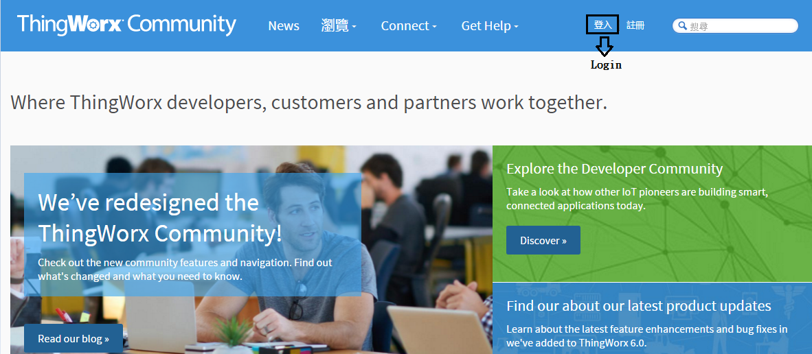

Hello everyone,
I have a question about the customer login.
How can customer first access the server without login page?
I mean that customer can see the mashup which i create for main page without login.
Like this page,without login.
Many thanks,
Allen
