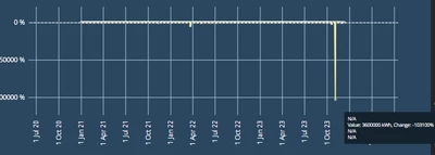

I have been using multiple data sources with line chart and want to customize the tool tip instead of Thingworx standard in the mashup and tried as follows :
${DataSource1:toolTipValue}#newline#${DataSource2:toolTipValue}#newline#${DataSource3:toolTipValue}#newline#${DataSource4:toolTipValue};
But in the runtime I'm getting tooltip as follows :
In runtime I'm getting 'N/A' if the value is not there for a particular data source in the hover point.
Is there any solution to hide out or remove 'N/A'  ?

A rather dumb solution would be to cram all 4 of your tooltips into one, e.g. on DataSource1. Then you can handle all "formatting" logic on the server side.
