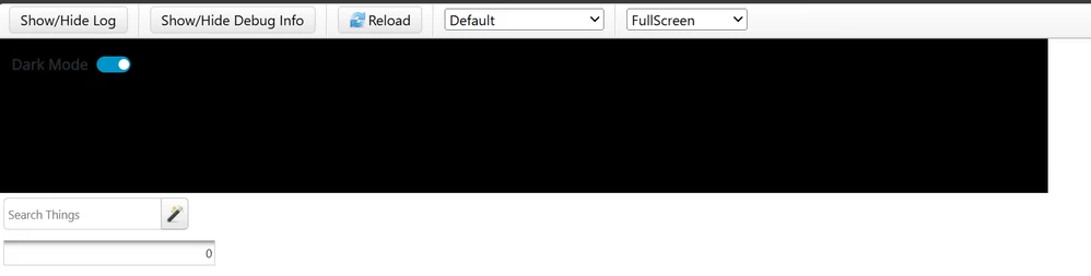

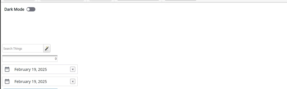

You can achieve using Custom CSS
Example :
CSS Code to change background color
.darkMode{
 background-color : black !important
.lightMode{
 background-color : white !important
 Based on toggle button state pass custom CSS class name to container. By this way you can achieve dark or light mode

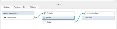

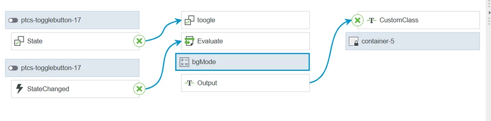

Expression :
if (toogle === true){
 Output = 'darkMode';
} else {
 Output = 'lightMode';
Bindings :
Result :

Hi, @Velkumar , Thanks for the response
I could not able to bind state with toggle
I am unable to locate toggle .
Feb 19, 2025 7:41 AM UTC
@Abhishek_Tirkey  Have you created toggle input for your expression ?
