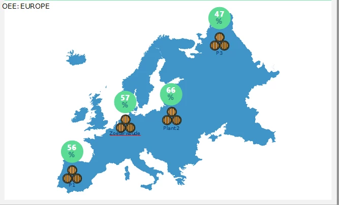

Hello users, I'd like to display the data (property value(s)) that change over time near/in-place of markers. I've already established mashup linking to that markers upon marker double-clicking by which the new mashup pops up. The issue is with displaying the data near/in-place of markers and displaying names near markers. Kindly look at the below image which elaborates my requirements.

@slangley ..Actually ,instead of going for extension development to serve the purpose, I've done it the other way. That is, I have used frame layout widget to visualize the data over the map. But, it has its own limitations.

It doesn't appear that we have a widget that will do what you need.  You can use tooltips to display property values or even a mashup, but only when hovering.
However, it may be possible to create your own extension to meet your needs.  Here is a link to the ThingWorx Extension Development Guide for more information.
