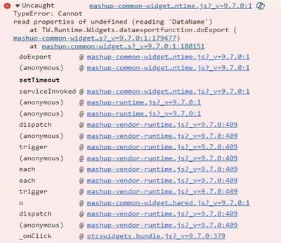

The Data Export in 9.7 has moved to functions as per the Release update Documentation, and when I tried using the DataExport function to Export on the Dashboard/Runtime, I saw an Error in the Inspect window.
mashup-common-widgets-runtime.js?_v=9.7.0:1 Uncaught TypeError: Cannot read properties of undefined (reading 'DataName')
 at TW.Runtime.Widgets.dataexportfunction.doExport (mashup-common-widgets-runtime.js?_v=9.7.0:1:179477)
After the error in inspect, the data is not exporting

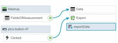

I figured it out. In my case, the EX-Developer connected the Infotable Parameter to the Export function. Still, for some reason, export does not pick up the data if it is from the Mashup Parameter...
Previous Approach:
Mashup Parameter to Export Function
Present-fix Approach:
Mashup Paramter to a Service to Export function (Now it works 🙂 )

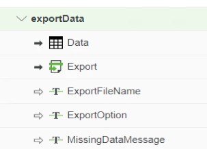

Screenshots from my side:

The usecase works for me with the exact same binding on 9.7 without an error. So I suggest
-to try with a different browser
-to check the data is not empty
-to create a clean mashup with just the grid and the button and the export function, nothing else
If you still can reproduce, create a ticket with support.
