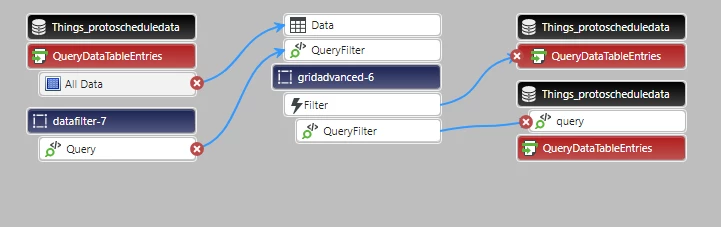

I'm having trouble getting Data Filter Widget to work with Advanced grid when Column Sorting is enabled. I tried passing the query from the Data Filter Widget to the Advanced Grid and then from there to the QueryDataTableEntries Service. The Data Filter works but when I uncheck filters the displayed data does not change. Included video for clarity.

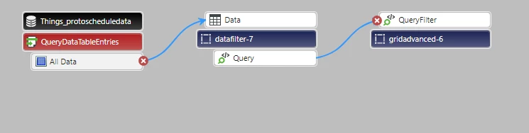

Have you compared your bindings to  the sample Mashup provided, WeatherExample? It's packaged with the grid advanced extension. I just tested sorting + data filter and it works fine in my 8.4.2
jsimms1-VisitorAuthor
Yes they seem to match.
Data Filter Bindings:

AdvancedGrid Bindings:
20-Turquoise
Do you experience the same issue when loading/viewing the WeatherExample?
jsimms1-VisitorAuthorAnswer
I just a talked to support. This issue is supposed to be fixed in version 8.5.
https://www.ptc.com/en/support/article?n=CS306055
