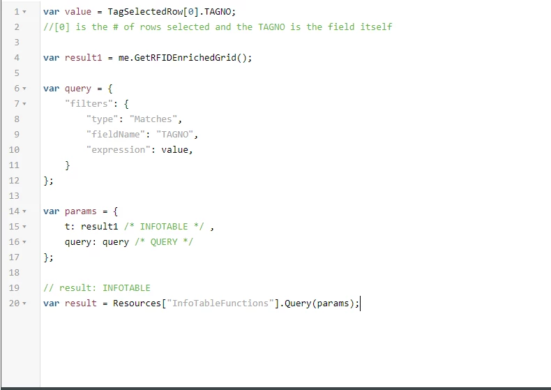

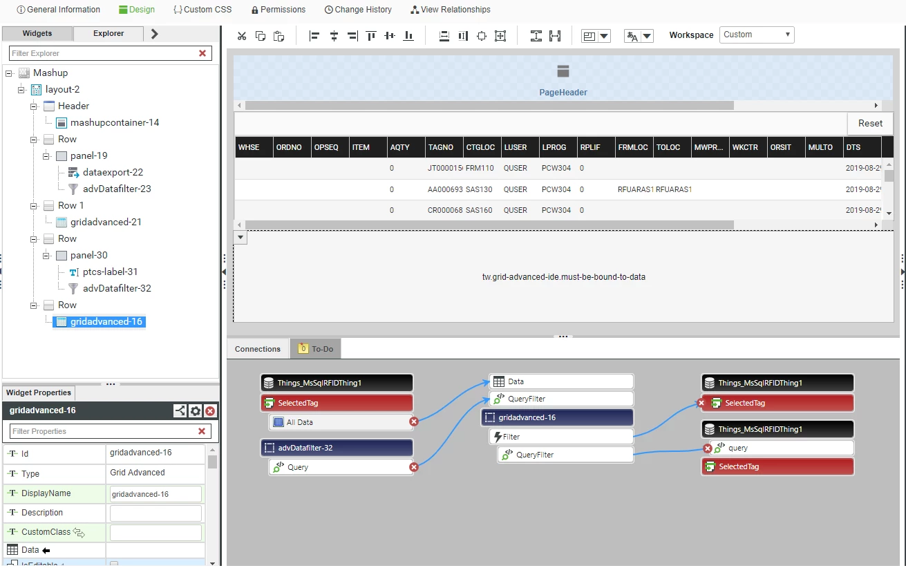

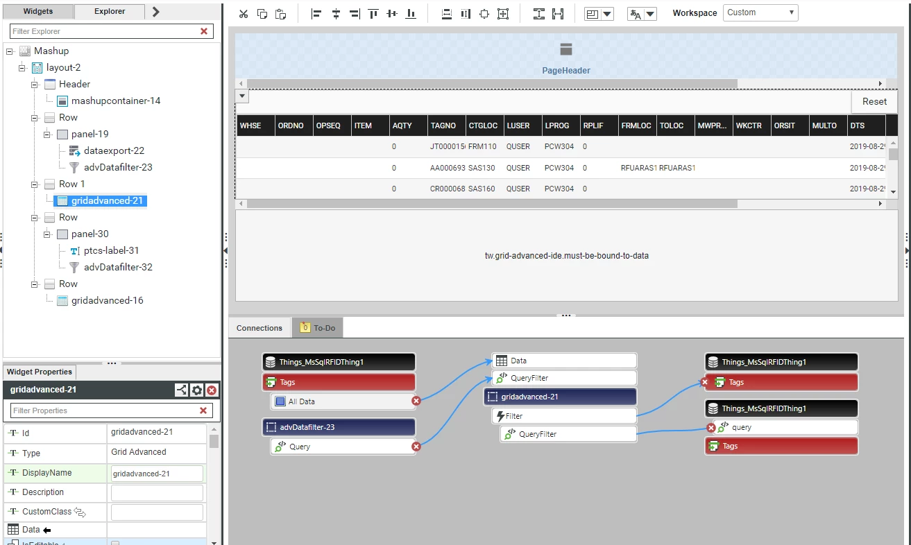

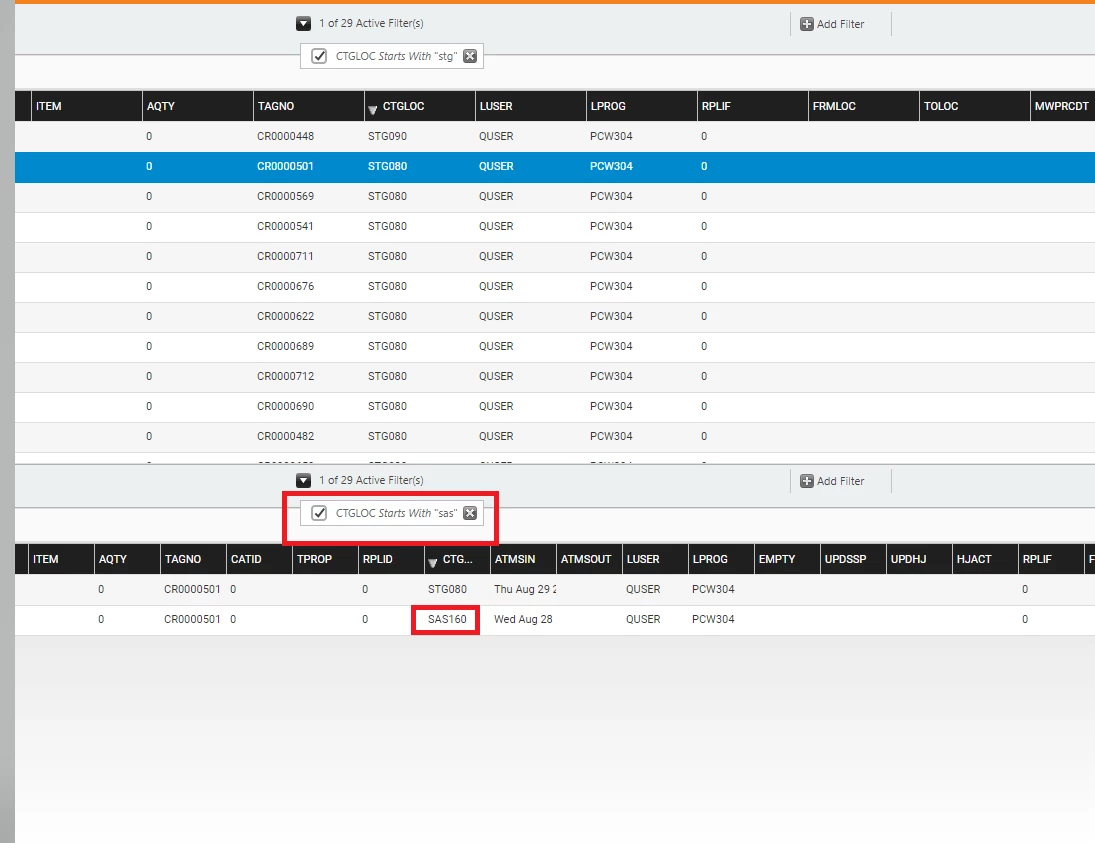

I have two Advanced Grids that i'm using for my mashup. Grid A populates Grid B based on the selected row and specific cell value. I can sort and filter Grid A but can't do that with Grid B. The bindings are the same on both between the filter widget and the advanced grid widget. I have attached some screenshots.

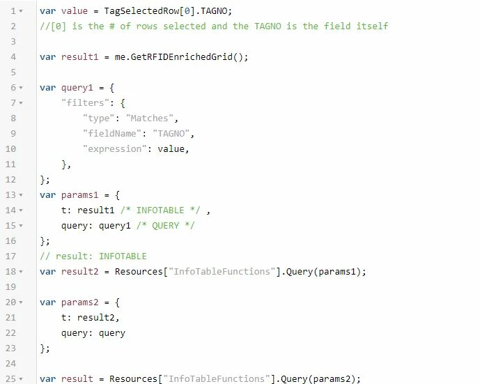

I ended up fixing it myself by making changes to the service. I re-queried the data that was coming from the first service.

My guess is that because i'm customizing my filter (in the service screenshot) on the second grid, its overwriting and data filter queries, could that be possible?
