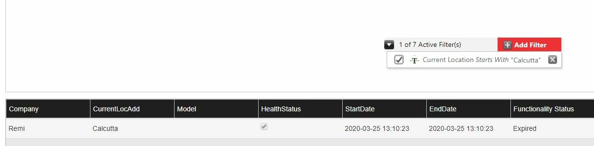

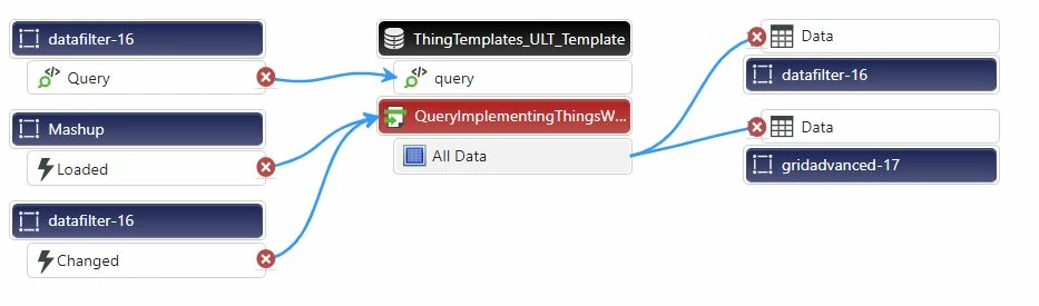

I have bound my data filter widget to a grid and it seems to be working correctly,but i wanted to know if i gave 2 inputs for the same filter,example :all data with the Current location : India and Current location : America.Is this possible in the inbuilt widget or do we have to write a service ?If so can you please send the code for this service.   Also any idea how to style the widgets drop down feature.

I believe the current DataFilter widget only allows a single parameter filter without any logical statements.
So what you want to do can't be done with it.
Not sure if you know what use cases you have for filtering, else you can just use a List and Multi-Select and build your own query.
