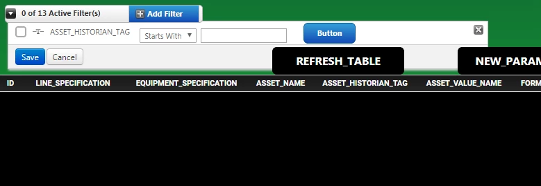

i am not sure if i am doing something wrong or that's a bug, i am trying to use a data filter widget but in runtime it doesn't work
i am unable to select the limit or click any of the buttons
PS. i used to have a mashup on an older version and the filter was working fine and when moved to 8.1 it doesn't work anymore and i am facing the same issue
can someone confirm or deny if they have the same problem ?

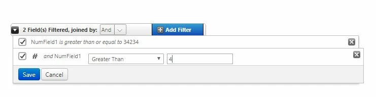

hi @labouzina i tested it out on 8.0 & 8.2 seems to be working fine on both. I don't have 8.1 readily available for testing. Is this happening on all browsers? Any error that you may notice in the ApplicationLog.log for ThingWorx or may be when you simply enable the developer console for the web browser during runtime of the mashup to see if that is reporting anything suspicious?  Below screenshot is from the 8.0 version13-03-2018 16-19-20.jpg
