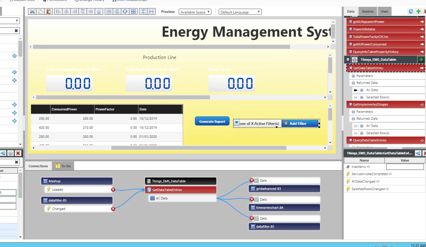

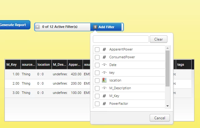

I have DataTable with some records , i want to use Data filter widget .but when i binds filter widget to "All Data" in Datatable Service . its showing field names in filter widget but unable to filter data. i need proper reference on it. which service needs to bind and which needs to create new one. i have attached screenshots plz see this and give some steps how we can get it.

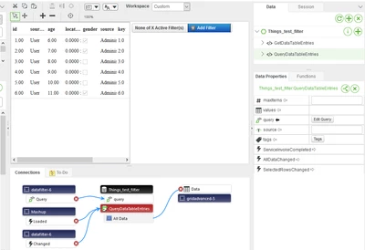

I recommend to use QueryDataTableEntries and create bindings in the following order:
- bind the Query from Data Filter to Query from Parameters of service QueryDataTableEntries
- Change event of filter  bind it with QueryDataTableEntries service
See below:
Hope it helps,
Raluca Edu
