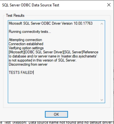

June 17, 2021
@slangley Can you connect me to someone in the Developer Team, This is a major issue I am facing for a long time.
I can't even connect the Postgres Server to !!

Support
June 22, 2021
Hi @pshashipreetham
Here's a link to the Help Center regarding the jdbc connector extension--I noticed you're trying to use odbc.  Please let us know if you continue to have problems after reviewing the article, and if so, please provide the version of ThingWorx you're running and further details of the issue.
Regards.
--Sharon
pshashipreetham
pshashipreetham19-TanzaniteAuthorAnswer
June 23, 2021
Hi There,
I have found out the cause for this issue, the reason behind this was the SQL Driver for ODBC was of the old version. When I have downloaded and installed the Latest SQL Driver for ODBC then it worked and connected successfully.
We can also connect to other Servers like Postgres by downloading and installing the particular latest driver for ODBC.
Shashi
