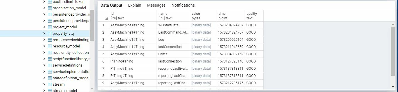

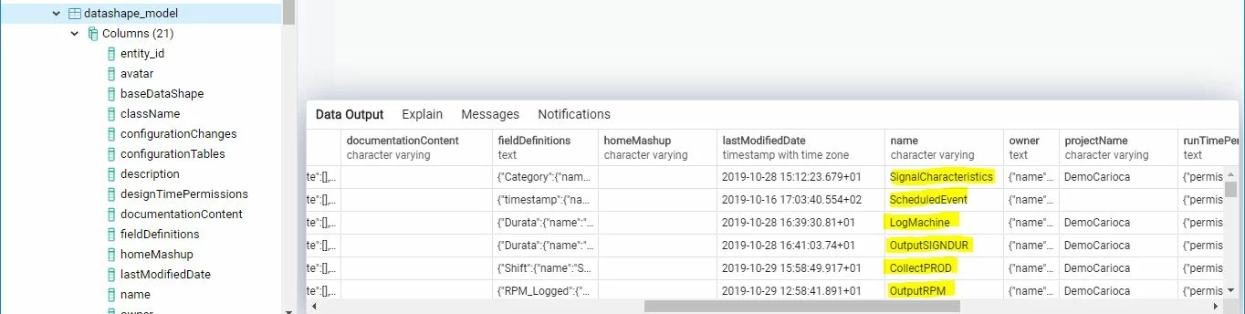

As you can see in the attached picture, I can see the names of datashapes that have been created on thingworx composer, but I'd like to understand that how is it possible to see the data stored in those datashapes using postgresql.

A datashape is just a definition.
Did you tie those datashapes to a Stream or DataTable to store actual rows?
Also what is your use case that you would need to see the data in the persistence provider directly vs. using the OOTB services available on Streams and DataTables?

Take a look at property_vtq table.

Still not able to see the data. The property names are Log and Shifts.

@mnaeem, So what happens when you execute something like this?
SELECT convert_from(decode(value, 'escape'), 'UTF-8') FROM property_vtq WHERE id = 'AssyMachine1#Thing' AND name = 'Shifts';
I don't have a running Postgres to test it right now, but I hope this gives a direction.
