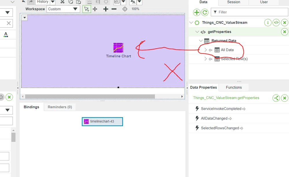

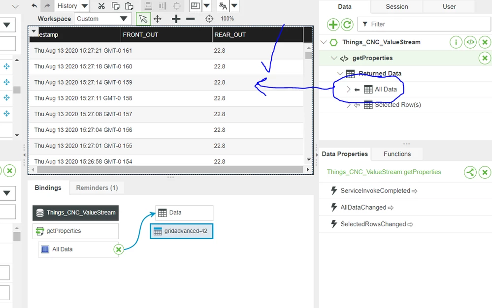

I have data that has been placed into an infotable via a valuestream. I can get this infoTable and it has a thingworx timestamp and two other columns with number data. For some reason I can bind this to certain widgets but not the ones I want. For example, I cannot bind it to the time series chart. I made sure the timedate was "yyyy-MM-dd HH:mm:ss.SSS" but no luck. Any ideas? Here is an image of each.

Which version of ThingWorx are you running?  What happens when you try to bind the data to the Time Series chart?  Do you receive an error?  Are you prompted for the binding target?

This is the hosted trial version 9.0
When I try to bind it literally does nothing. I drag and drop it, and nothing happens. I can bind it to line charts and other widgets but not the time series one.
August 19, 2020
Is it because I am trying to bind a datatype infoTable? If so, what data type do I need for this? I made the infoTable from a valueStream.
