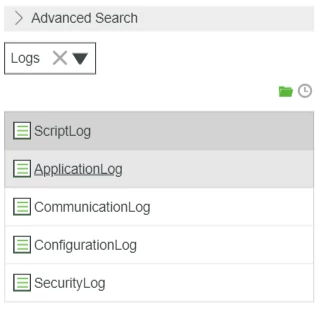

@KN_9954684
GetLogEntries will only work for below logs.
One of the possible solutions to load the Database log in a mashup is via a custom extension. You can refer this article, it explains how to get contents of a file on a drive from ThingWorx service.

@KN_9954684
