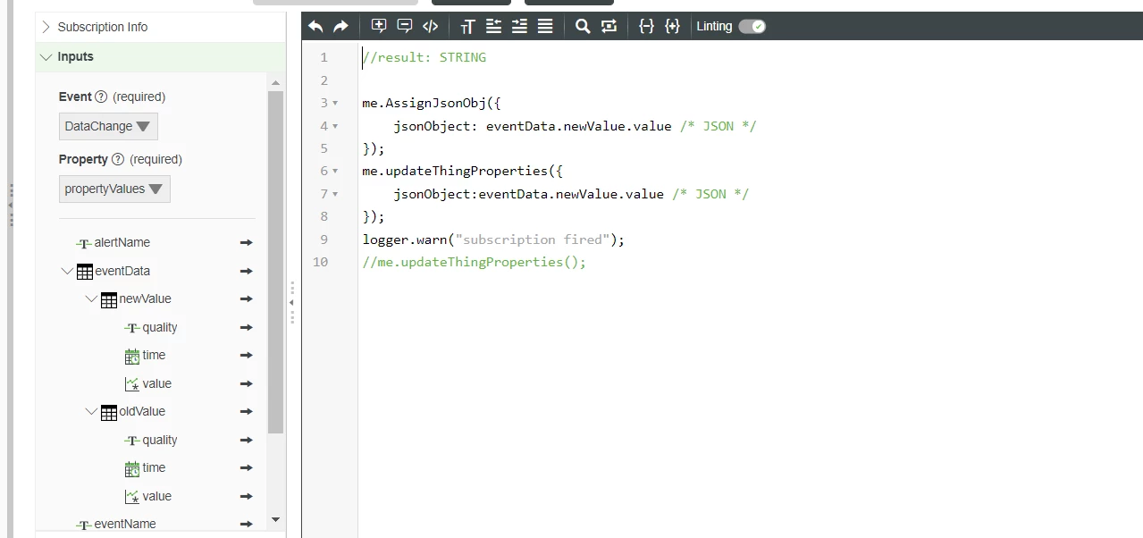

Just to give some context, the exercise I am doing is on a ThingWorx server.
I have values coming from MQTT and it updates the JSON. I have written a service that takes JSON values and passes them to the respective thing property. A subscription calls this service. The values on the property are not still updating. Even after I gave run time permissions to the system user. I've also got a persistent provider, are there any changes that I need to make on this?
Is there something I am overlooking ?

Hi all,
I found the problem.
It was in the subscription.
The correct code for the subscription is in the image below.
