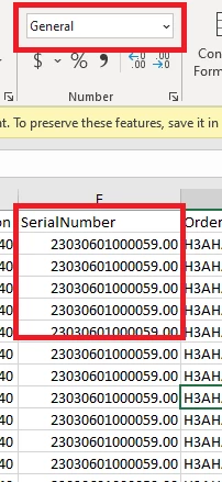

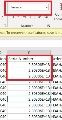

When this infotable is provided to "DataExport" widget, it downloads a ".csv" file, which shows the "Serial Number" column formatting as "General" and hence the pure numeric values displayed as "2.303036E+13".
Where as it should show something like 2303601000059.

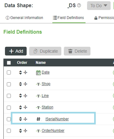

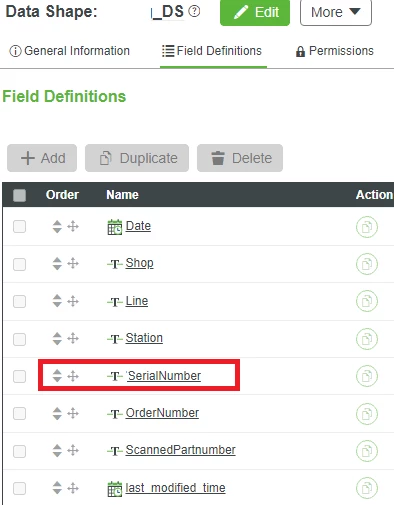

I tried the filed definition datatype as "Number" as well as "String", but getting the same result.

serialNumber When Column Formating is General.jpg.pngserialNumber when column formating is General.pngwhen field definition is Number.pngwhen field Def is string.png

If I'm not mistaken, it looks like that because excel automatically converts long numbers into scientific notation.

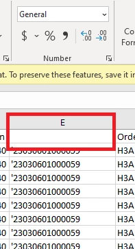

Thanks for your suggestion, I wish this workaround could work, but I tried with concatenating the number with " ' ".
But If I do so, two things are happening,
1. Loosing Column name
2. " ' " is visible in the column values
The column size in excel doesn't make any changes.
