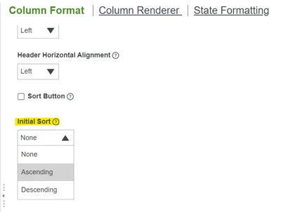

Hi @MA8731174
Did you tried Initial Sort in Column Format ?
/VR
