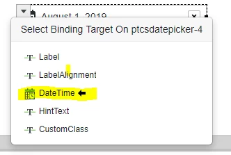

When you are defining the object to bind to the date picker, is it a DateTime object?
If the data is not a datetime then you do not get the option to bind to the date picker value.

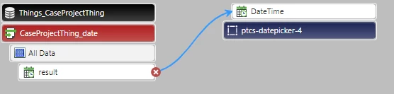

 In this case I am dragging a datetime result to the Date Picker and I want to bind it to the  DateTime item.

Hi Pehowe,
I tried to do that, but even if I bound date it is not displayed. How can I sold this?
