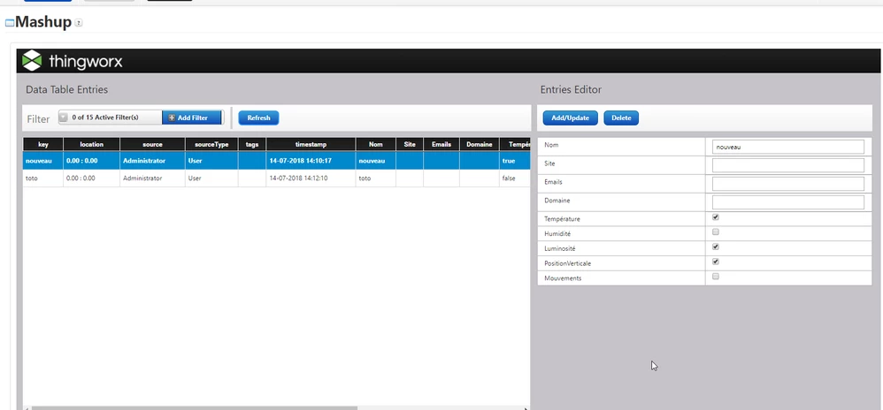

I'm trying to implement a mashup to edit/add/remove rows in Infotable exactly on the model of the "home mashup" of the infotable.
1/ Is there a way to duplicate these system mashups to reuse in own application  mashup ?
2/ If not which service to use for "add/update" in a single button (if the entry doesn't exist : add , if exist : modify)
Is there an existing service for that ?
pjolyAnswer
July 15, 2018
I did not find how to reuse home mashup but I used the service "AddOrUpdateDataTableEntries" to associate to the button "add/update"
