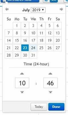

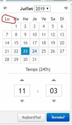

currently experiencing an issue with localisation with the date picker. It appears that the calendar displays incorrectly in French (and possibly other languages which I haven't checked).
The issue is that the days of the week are a mismatch with the actual calendar below. The reason for this is that in French the days of the week start with Monday ('Lu') where as in English they start with Sunday ('Su'). The actual calender days are always arranged as if the first column is Sunday.
Presumably there is an array of strings somewhere, but I am not able to find it to modify it. Does anyone have a solution for this, or has seen this issue also?

Okay, so I have found the localistion token which is used for the date picker short day names which can be found in the localisation tables.
token = datepickerDayNamesMin

Hello @khayes1 ,
   The link shows the documentation for “Localizing the Date Time Picker Widget”, and the configuration variable “datepickerDayNamesMin” has the short abbreviations for the days of the week starting on Sunday.
What is the next property setting? The “datepickerFirstDay” identifies what day is the first day of the week. What value do you have sent in your environment? To have the week start on Monday it should be set to 1.
khayes11-VisitorAuthor
July 25, 2019
It is the zero based index (as a string 0-6) into the datepickerDayNamesMin array. You use it to set the day of the week you want the first column of the calendar part of the date picker widget to be. I think it uses the array above, but haven't checked it out, it could be done on the international standard which I think has Monday as the first day of the week.
eg. if your datepickerDayNamesMin  token was 'Su,Mo,Tu,We,Th,Fr,Sa' and you set your datepickerFirstDay token to '2'  the first column in your date picker calendar would be 'Tuesday' for that particular language.
