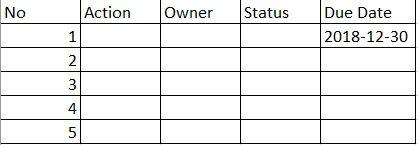

Hello Everyone,
I have Question If Possible have date pickup inside Grid table
in the below table for daily action i want when the Clint click on Due date open date widget to select instate of write by hand
Islam
Best answer by MichalC
Assuming your actions (rows) already exist, then
1.Double click a row
2. use navigation widget to open a new popup mashup
3. pass parameter of the ROW_ID to the new popup
4. use a date widget so Client can enter or select a date
5. use button to trigger a SQL UPDATE service for the ROW_ID
6. on close of the popup, refresh the grid, so client can see the updated row with date
this way you add a date to existing action

i I believe that  right way to do it , Could you Please explain with Pic
