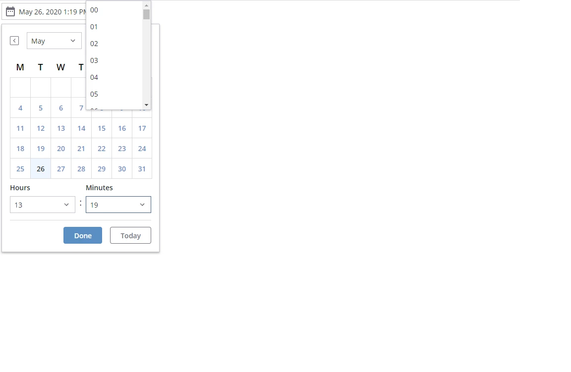

Date Time Picker widget on Thingworx Platform 8.5.2 has a visualization problem that we don't know how to solve.

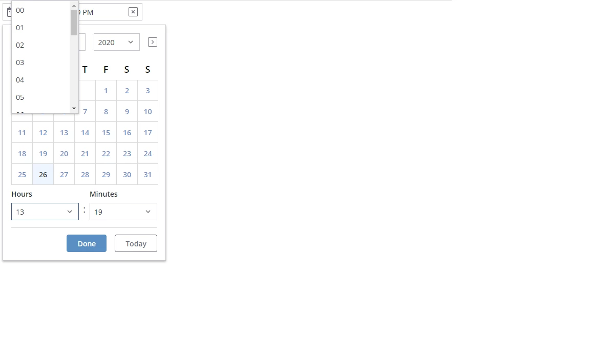

When you try to select the hour or minute, both lists are displayed on the top (see attached image).
The lists should be displayed near the hour and minute selector. It happens always, it doesn't matter if it is enough space or not .
The same happens with the year selector and related with this there is an article (https://www.ptc.com/en/support/article/CS317335) but this article doesn't mention the problem with the hour and minute pickers, it only speaks about the problem with month and year picker.

@olatz ,
I have seen the issue you describe. It is reported as fixed in ThingWorx 8.5.4
HTH
