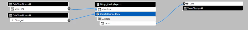

Here is the bindings. I have when the event the datetime is changed call the method UpdateChangedDate and display the result to the value display widget.binds.png

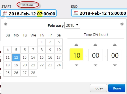

When mashup firsts loads the at Feb 12 2018 07:00:00. I change the hour to 10:00:00 not the day. (Changing the day works.)

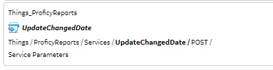

I click Done but the value display has not changed.2.png It does not show the change date as a input to the UpdateChangedDate. I just made this simple js for this method to show that the event Change on the datepicker is not working for when hours are changed.
var result = datetime;
//datetime is an input.
I have tried changing IntervalType on the datepicker. I have tried Days, Hours, Minutes and Seconds. Anyone have an idea?4.png

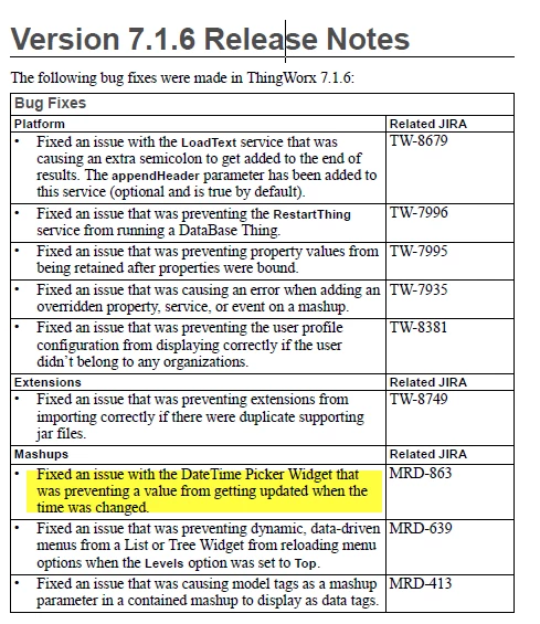

Apparently it is an error on this version.
