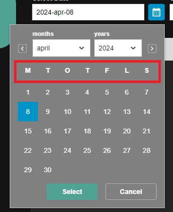

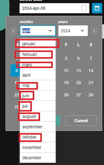

DatePicker widget language error
I have not set language preference for the datepicker widget. By default it should be english, but my widget is a mix of both english and another language. Please refer to the attached screenshots for more information. Any help is greatly appreciated!
Apr 10, 2024 2:07 PM UTC
I did set the user language preference to English is User's General Information and the issue is resolved.

@bchaudhary_448008 , I have imported a custom font into SystemRepository that I use for the project. I have the month and day issues only when I use the custom font. I tested with multiple custom fonts and every font I use produces the same language error. But it works fine with default font families provided by Thingworx. I hope this will help you to troubleshoot!
Also, my language selection is default.
