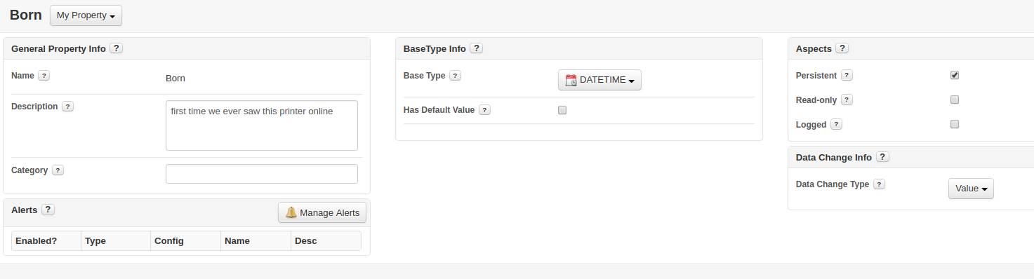

I have a DATETIME property named 'Born' which records the time at which a remote thing is created on the server. I create the things via a service I wrote, which monitors for unbound devices and then creates an instance from a template I created. Immediately after the thing is created I set this property to the current time. However, I have noticed that this property updates to a later time periodically, even though I don't have any other service which sets this parameter. At first I thought there might be some old service that was being called that assigned a new time value to it. To check this I exported all my templates to an xml file on my pc and then searched for occurrences of the property 'Born'. Aside from the definition of the property in the template it only occurred in one other place, my create service.

Although most of my things were created months ago the 'Born' value on those things reads as times from earlier today. does anyone have any idea what might be going on?

I've since discovered that the 'Born' DATETIME property is getting updated to the current time on my things, every time I modify the template on which the things are based.
i.e. If I add a new property to the template the 'Born' property on my things get updated to the time I save the changes to the template.
Is there any way to stop this happening, All the other properties that are remotely bound do not change. Is there some setting that I should have used?

It are declared as persistent?

Hi Carles, thanks for replying. Yes it is declared as persistent.

Then I don't know, It seems a bug, I sounds to me that there was this kind of bug on a TW version. Had you checked the release notes of TW Versions
