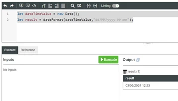

Jun 3, 2024 12:24 PM UTC
Hi @MD_10945249
You can dateFormat function to convert dateTime to formatted string
let dateTimeValue = new Date();
let result = dateFormat(dateTimeValue,"dd/MM/yyyy HH:mm");
/VR
Jun 3, 2024 12:31 PM UTC
This is to format the date but I what I want to achieve is to transform my Start_Date comming from a service that is in utc to be converted to the date and time of zone in which it was entered.
Rocko
