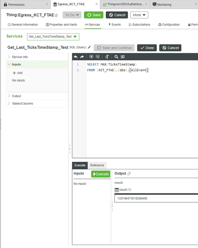

I have a service on a database entity, executing a simple select max() operation, when running in the entity, it works and returns a result (number) as shown in the screenshot. but when I call this service from another db entity as below:
    lastTickTimeStamp = Things["Egress_KCT_FTAE"].Get_Last_TicksTimeStamp_Test();
it always return null as lastTickTimeStamp;
However, the other serivce (query to return an infotable) on the Things["Egress_KCT_FTAE"] can work in the same location without problem.

The SQL service returns an infotable, so  to get the value you might need to do lastTickTimeStamp .rows[0].lastTickTimeStamp. Use alias in the SQL like MAX(lastTickTimeStamp ) AS lastTickTimeStamp
