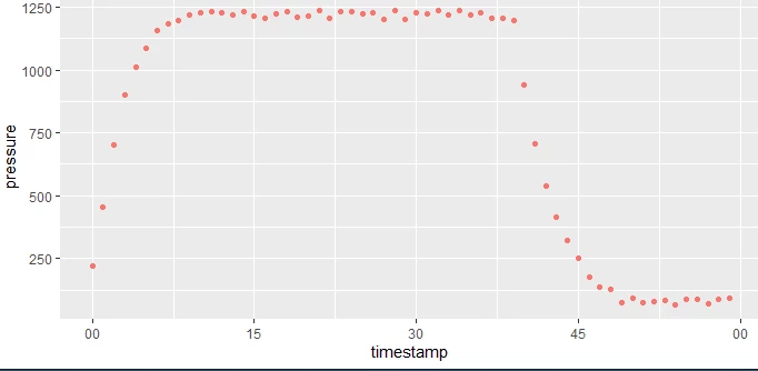

My use case consist of machines sending data periodically (when machines are on). I want to predict failures.
I created a dataset with computed features for each on cycles and  then create a model on TWA.
But features are complexes to compute inside TW, so putting this model to production will be unconvinient.
I have 2 questions to make a better/easier use of TW for this use case (and for my personnal understanding of TW) :
  • Is there a way that Thingworx can handle breaks in time series to create a model?
  • Can Anomaly detection understand this kind of pattern and don't mind of time gaps between the next cycle (see joined image of a normal and failure cycle).

plpt1-VisitorAuthor
Thank you for your response @nsampat, I did see these articles.
From what I understood time series model can not contain time intervals without data.
But since it's common in the industry maybe someone can give some tips and feedback from their experience.
