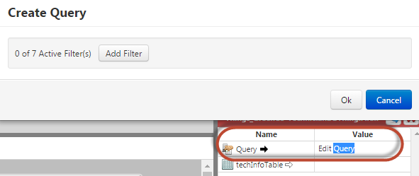

Hi Guys,
I have following (maybe dumm) question.
I am using a DataFilter widget I can see that query property is bindable in both directions. I would like to create sort of "default query" for my queryService which would persist.
I have assigned query from DataFilter widget and added one filter to query inside service parameter directly. That one does not seem to take any effect.
How to create a default query for DataFilter widget. I was thinking about to create a property(ies) inside some thing which would hold the queries, but its not as flexible as I would like to be.
Any ideas?

In order to combine and personalize the query used by the DataFilter widget, I used a service (QueryProcess, for example) to parse its query (a json) and to recreate my filter by combining with other criteria. So I think that you can bind the DataFilter widget's query property to this service QueryProcess. If the query is empty, the service can return a "default" query which is bind to your final service.

Hi Sushant,
not quite.. I dont know what you mean "can be held inside the query service itself", I know that you can edit the Query in mashup (pic above). Problem is that DataFilter widget's query is bound to service query parameter, but at the beginning that widget query is empty because nothing is bound to it in opposite direction (and I cannot use Query paramater as input parameter for that widget), thus reseting the service's query parameter.

To answer your other question, as a matter of fact you can use OR -  Queries allow you to use AND / OR, may be you want have a look at the Query documentation with all possible combinations.
Yes, but current DataFilter does not include this option, or does it?
U suppose I can follow Ngo's proposal, to create a service which will validate the query made by DataFilter widget, and it will set AND to OR depending on some other widget's state (list, radio button etc.). Not very flexible and elegant, but certainly valid option (or am I mistaken?)
