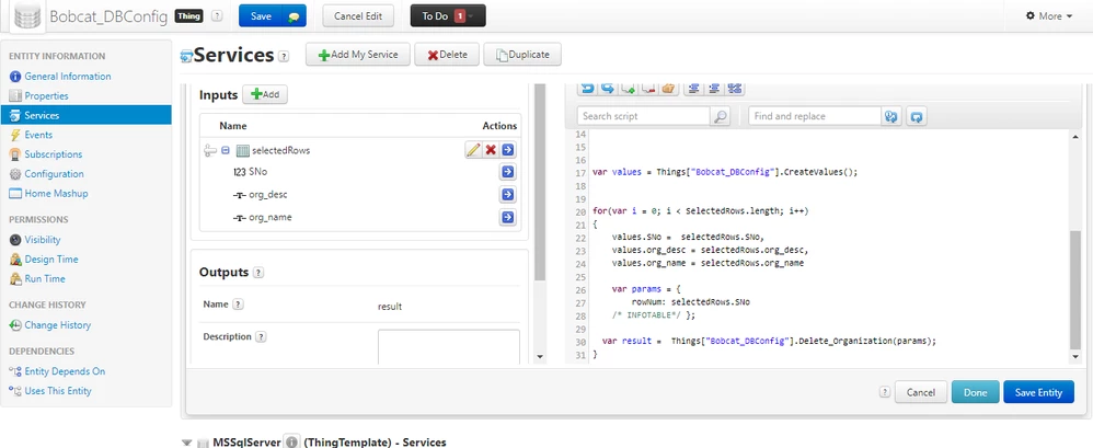

I wanted to delete multiple rows in sql database. I have given the input as infotable which has default datashape that I have binded the grid to. The grid data selected rows I am giving as input to the multi delete service infotable ip. I tried using the grid advanced but the code does not work.
The Things["Bobcat_DBConfig"].Delete_Organization(params) is the service which has sql query to delete the row (
WITH cte AS
SELECT ROW_NUMBER() OVER(ORDER BY org_id) AS Row
FROM Organization
DELETE FROM cte
WHERE Row = [[rowNum]] )
multidelete.pngHow could I resolve this?

Are you deleting data from Datatable (js service) or External Database (sql command)?
The Thing in your screen shot is a Datatable, but you mentioned sql database a lot.
If you want to delete multi-row in Datatable, use the
DeleteDataTableEntries / DeleteDataTableEntriesWithQuery service

I wanted to multi delete the data in external database using multi select option in advanced grid.
Apr 24, 2019 8:03 AM UTC
The advanced Grid widget will send out infotable result. Check what infotable you'll get, and then use this infotable as input to trigger the SQL commands.
SQL command usually receive 1 row of data each execution, so you may need a Javascript to iterate each row of infotable and trigger the SQL command, make it a loop.
