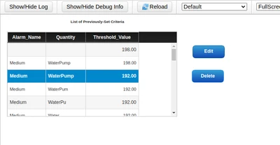

Jan 28, 2021 8:01 AM UTC
Got the Simple Solution,
1. Make Sure the Thing BaseTemplate is DataTable
2. Such that we can find lot of Services DeleteDataTableEntries, DeleteDataTableEntry and DeleteDataTableEntriesByKey.
3. For me the Row in the Grid got deleted for all the three services.
4. Create a Checkbox Column in the GRID and make it "Editable" and put the default value as False.
The Grid's Edited Table is the INPUT for the following Service
for (var i= 0;i<EditedTable.length;i++)
	 var row = EditedTable.rows[i];
 if(row.CheckBox ===true)
		 var values = me.CreateValues();
 values.Column1 = row.Column1;
 values.Column2 = row.Column2;
 values.Column3 = row.Column3;
 values.Column4 = row.Column4;
 var params1={
 values:values
 Things["DataTable_Name"].DeleteDataTableEntry(params1);
Jan 24, 2021 1:50 PM UTC
Hi @SP_9715784
Thank you for opening this thread on community. Are you using infotable to populate data on grid?
Check this thread if it helps:
https://community.ptc.com/t5/ThingWorx-Developers/selected-row-remove-on-infotable/td-p/664766?posno=9&q=delete%20selected%20row&source=search
regards,
Mohit
Jan 24, 2021 1:52 PM UTC
SP_971578412-AmethystAuthorAnswer
 var params1={
 values:values
