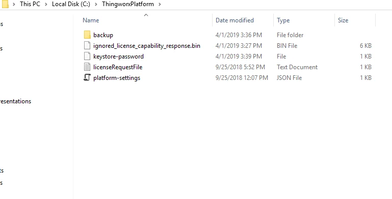

I have an issue in deploying war file on the server. whenever i deploy war file my tomcat server stops after few second automatically. I've tried reinstalling everything again, but I still have the same issue. In application log file it shows the license expiration issue. for this i have regenerated the license ,but still i am facing the issue.
Here is the log files attached of my last try.
Below is screenshot of an issue i am facing whenever i deploy my license file and restart my tomcat and trying to load it.
Thanks in advance.

Since you reinstalled the product, the Device ID would have changed.  Did you generate the license for the new Device ID?  Check \ThingworxStorage\logs\ApplicationLog.log to be sure you're generating it for the correct one.
If you still have issues, we can open a case for troubleshooting.

Seems to say your Thingworx license is expired.
So I think Thingworx is shutting down, but I think Tomcat is still running
