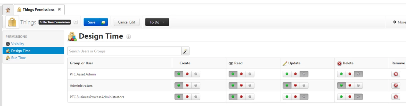

Hi Community,
I wish to design permissions on thing permissions programmatically:
Does anyone have any advice on how to achieve this?
Andy

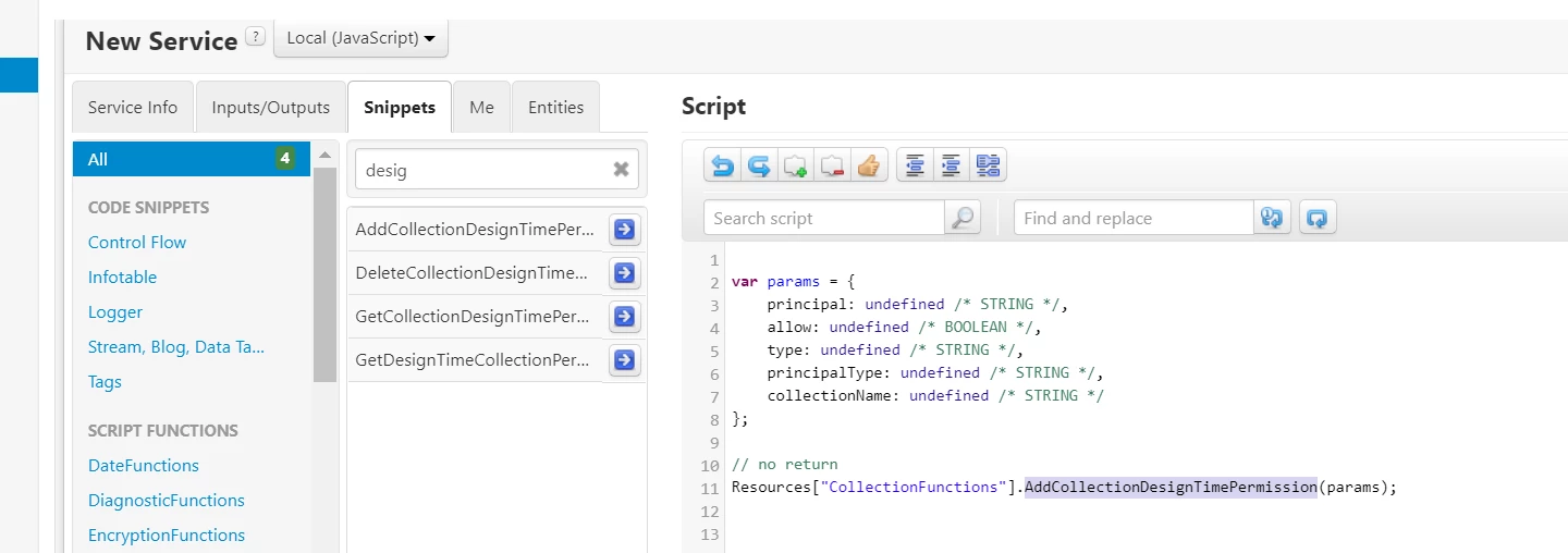

You can use AddCollectionDesignTimePermisson service for this use case .You can find more details of using this service in help center as well .
public void AddCollectionDesignTimePermission(java.lang.String collectionName,
 java.lang.String type,
 java.lang.String principal,
 java.lang.String principalType,
 java.lang.Boolean allow)
 throws java.lang.Exception
Service Category:
Permissions
Service Description:
Add a design time permission.
Parameters:
collectionName - Collection name (Things, Users, ThingShapes, etc.) - STRING
type - Permission type (PropertyRead PropertyWrite ServiceInvoke EventInvoke EventSubscribe) - STRING
principal - Principal name (name of user or group) - STRING
principalType - Principal type (User or Group) - STRING
allow - Permission (true = allow, false = deny) - BOOLEAN
Throws:
java.lang.Exception
you can find this service in thingworx snippet as attached

May 16, 2018
Perfect Answer - Appreciated.
Andy
