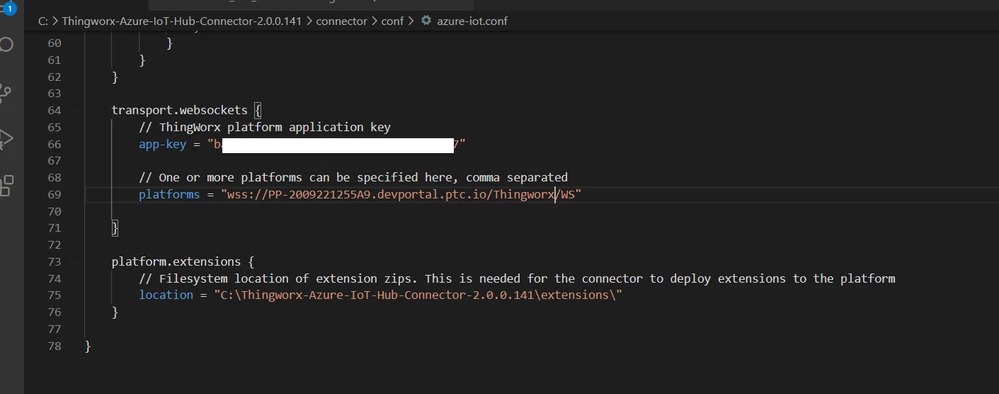

I have the 90 days trial version of ThingWorx Foundation.
On the guide to Use the ThingWorx Azure IoT Hub Connector with simulated appliances, i can't find the host and the port.
What i am supposed to put for :
    transport.websockets {
        // ThingWorx platform application key
        app-key = "xxxxxxxxxxxxxxxxxxxxxxx"
        // One or more platforms can be specified here, comma separated
        platforms = "wss://<host>:<port>/Thingworx/WS"   <== here
Thank you very much
7 replies
September 24, 2020

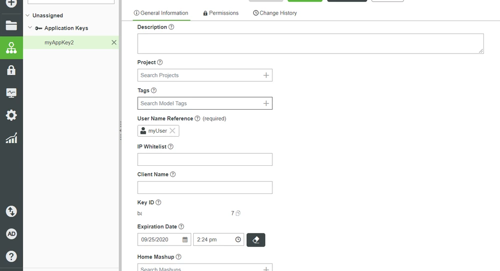

Create an application key from Thingworx composer by logging into https://PP2009221255A9.devportal.ptc.io/Thingworx .
Use this app key in the azure-iot.conf like app-key ="paste the app-key here" and
platforms= "wss://PP2009221255A9.devportal.ptc.io:8443/Thingworx/WS

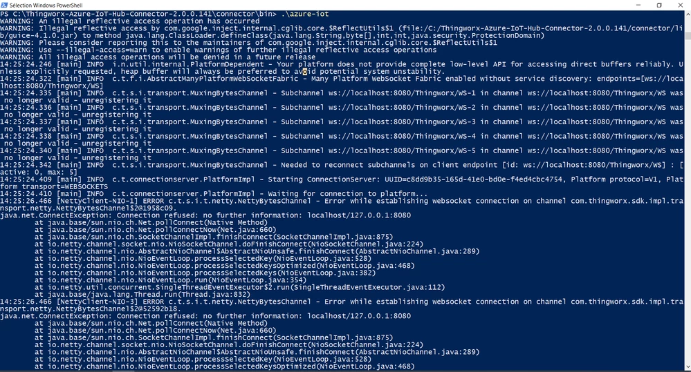

Thank you for your fast answer.
I did as u said but still can't connect.
I'm 99% confident about the settings from azure i entered in the config file.
Any idea ?
cf screenshots below
September 24, 2020
Thanks for sharing the screenshots, I am not sure but are you trying to connect Azure IOT hub connector version 2.0 with Thingworx 9.0 ? I think that's what you mentioned in your first post. Azure iot hub connector version 4.0 is supported with Thingworx 9.0 you can also check complete setup details here as well - http://support.ptc.com/help/thingworx/connection_services/en/index.html#page/thingworx_cx_services%2Fazure_connector%2Fc_azure_connector_hc_top_level_page.html%23 .
And if I have mistaken in your ThingWorx version then please let me know, hub connector version 2.0 is supported on versions prior to 8.5 .
