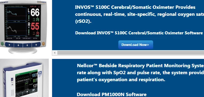

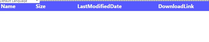

Mar 10, 2018 5:46 AM UTC
doanload list.PNGHello PaiChung,
Very thanks for your reply-)
Is there any chance to develop a landing/home page with dynamic product listing that was public view(any one can visit the url) after clicking on product user will navigate to this login and then down load list page please help me weather it was possible with thingworx or not, If yes how can i develop dynamic thinglandingpage.PNG

Easiest probably is to use a regular Web page as that 'public' portal.
You can use a very specific Rest call to Thingworx if needed to retrieve the list and use an appkey so it is sessionless.
Then when the click and are asked to put in their user name and password, you can use a form to pass that information into Thingworx.
It is a much bigger challenge to do this all within the Thingworx environment, because Thingworx only has the FormLogin page available unsecured. For the rest you have to establish a session.
You could establish a generic session, then Kill the Session with a re-direct to the FormLogin
