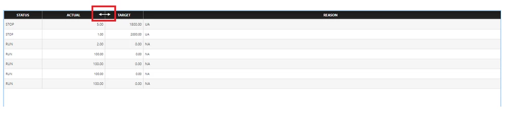

I am using an advanced grid on my mashup to show some data.
I need to disable the re-sizable feature of columns on grids.
Below is the snapshot displaying the feature that I want to disable.Resize.png
Is there any way besides building a custom widget, in which I can achieve this?

You could configure it to a fixed size, pg 35 of the grid advanced documentation https://app-direct-www-cloudfront.s3.amazonaws.com/downloads/229413/AdvancedGridWidgetsExtension4.2.0.pdf

I tried setting static widths to the columns. Both using pixel width and percentage width options.
However, at run-time, the user is still able to resize the column-widths by dragging the edge of the column.
I want to disable the dragging feature. Is there any way we can do that?
