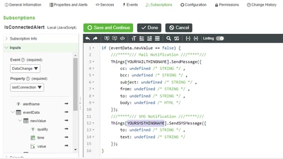

HI @Siddharth_Jhs,
Based on the Property - "IsConnected" of the Industrial Machine Thing,  you can create the Subscription in that Thing with the event of "Data Change" to trigger the code automatically. If the property value changes to False we can send Mail/SMS or other notifications to the customer based on their requirements.
Or You can create Alerts for the property by configuring the "Alerts" to that "IsConnected" property value equals to False, with the default current alert services also you can notify your customer that machine connection is down.
